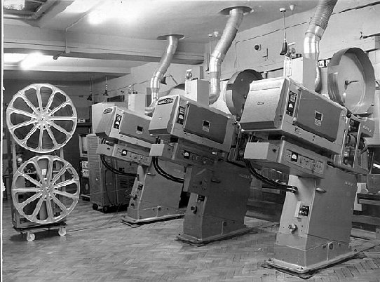

Gordon wrote, Morganite made a lamphouse called the autoarc that used a set of rollers to advance the copper coated carbons through the jaws and supported longer carbons. It also autostruck and used a thermostat styled position sensor like the mighty90/futuraII I always wanted to get a pair of those if any are kicking around cheap Les Brock wrote, Favourite Booth. Odeon Leicester Square. Also Nigel makes a mean cup of tea !!!! Here is the Odeon, Leicester Square in the days of the Victoria Xs and Elidophor television projector. The Auto-Arcs having been converted to xenon. One of the Victoria X 35/70mm machines has been installed in the projection room of the Projected Picture Trust's Enigma cinema at Bletchley Park. www.ppttrust.org
