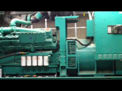

              The AMC/Sundancde/Carmike Kabui building has its' own diesel generator back-up power
              system, which supplies emergency lighting and some other power to both the theater and
              several attached businesses in the same building. It's a huge power plant located, surprisingly
              (to me anyway) on one of the top floors of the building. >>> ACTUAL PHOTOS BELOW! <<
              This big friggin' generator is at least the size of a Volkswagen bus! There's a main
              fuel tank located at ground level, from which fuel is pumped up into the smaller tank
              which is surrounded by a 'spill/leak enclosure' on the right side in this photo.
              Here's another side view. I know from a test/maintenance log book I saw
              hanging nearby, that they fired this thing up several times a year for testing.

                  This is start up of the generator. Ear covering required!

                          The generator in Jim's pictures is similar to the one in the hotel where I worked. The only difference that I can tell from memory is that ours was Ford Blue.
                          Memory fades but, as I remember, we had to fire it up at least once every ninety days. I don't know if that was code or whether it was company policy. I remember because, on one occasion, I was told to go down to the generator room and start it up so that it could warm up before the building Electrical Engineer came down to take readings and fill out log sheets. On another occasion, there was a power failure and I was told to go down to check to be sure it was running. Basically, all I had to do was check to be sure that the gauges were all in the "good" zone and that there were three green lights on the transfer panel.
