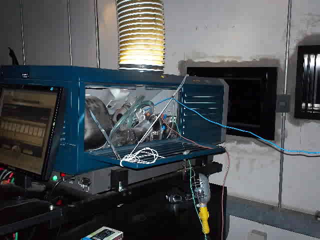

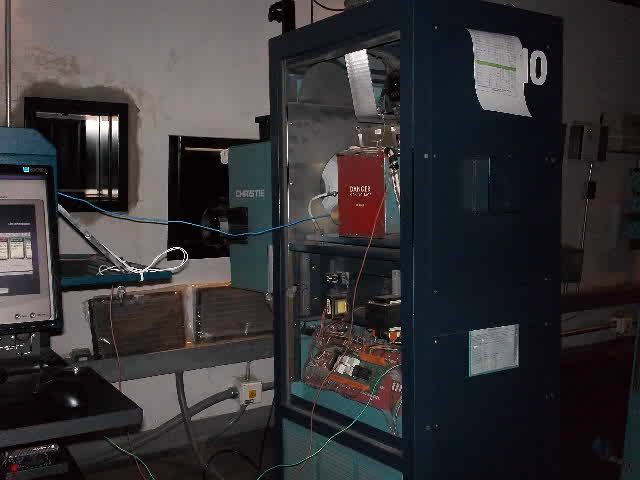

I don´t mean to be a prick, but get used to it. Not a week goes by without one of "my" digitals giving me a headache. I have been using all resources available to me to fight management NOT TO RIP OUT any 35mm when we "upgrade" an auditorium to digital. So far I´ve won all those battles. However I can feel it in my bones that my first defeat is coming sooner than later.
On their side I have to admit that EVERY SINGLE time that a digital went belly up for a considerable amount of time, we were not able to procure a 35mm print to try to salvage some of the lost income.
I have come to accept this fact: There is no way that 100% of digital 3D machines (regardless of brand and model) will work 100% of the time in any multiplex.
While in 10 years I have never ever lost one entire day due to 35mm malfunction, in the first year of showing 3D I have lost 6 (non-consecutive) days in one particular auditorium.
All is not lost, though. Not long ago, 35mm came to the rescue of his retarded cousin. See pictures below.
What you see is an SLC-40 igniter hooked up in parallel to a dead Irem Igniter (belonging to a CP2000XB). When it came time to start the show, we would manually strike the digital bulb from the 35mm lamphouse.
HOW ABOUT THAT??
BTW, it remained like that for a month, until I received my spare igniter. Keep in mind that if there is an ass end of the world, I live in it.
