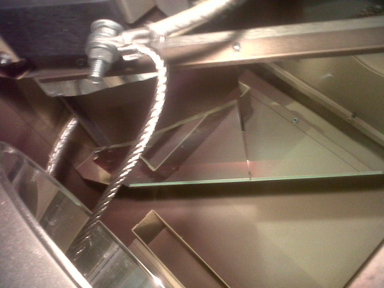

Tonight we had a xenon bulb explosion in one of our projectors. The bulb is an Osram XBO 3000w HS that I installed just last week. It had 32 hours on it. Installation went perfect and the light on screen was perfect. Bulb voltage and amperage was in spec. We have never had any bulb problems before. The exhaust fan is working properly.
The equipment is an ORC Optimax II-S Console with a DV-3000 lamphouse with XPS-30 power supply. The metal aspheric collector has numerous scratches and marks from the explosion. The 45 degree mirror is made up of two pieces. One of the pieces is damaged, the other looks ok.
Where do I go from here? Should the collector be replaced? Where can I get a replacement mirror? Should I have any part of the power supply tested?

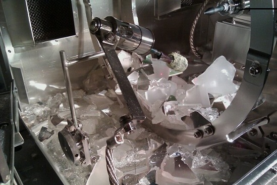

Chase Pickett
Posts: 142
From: Irving, Texas, USA
Registered: Nov 2010
 - posted 11-30-2010 04:14 AM      Profile for Chase Pickett   Email Chase Pickett   Send New Private Message       Edit/Delete Post

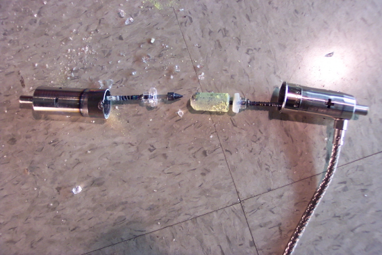

To start looking for the problem, I would first inspect the bulb that exploded. Well what's left of it. I had a bulb explode in a sony 4k two or so weeks ago (taking out the $8,000 or so reflector,)and when I looked at what was left, we figured that the envelope wasn't sealed properly, letting xenon escape, and allowing air to contaminate inside the bulb. It only had 40 hours or so on it as well. One sign was the anode/cathode were discolored (a bluish green color.) If you notice something with the bulb then you may have found your culprit. If not, break out the multimeter. Lesson learned. Thoroughly inspect each bulb going in. Just wish it wasn't such an expensive lesson.

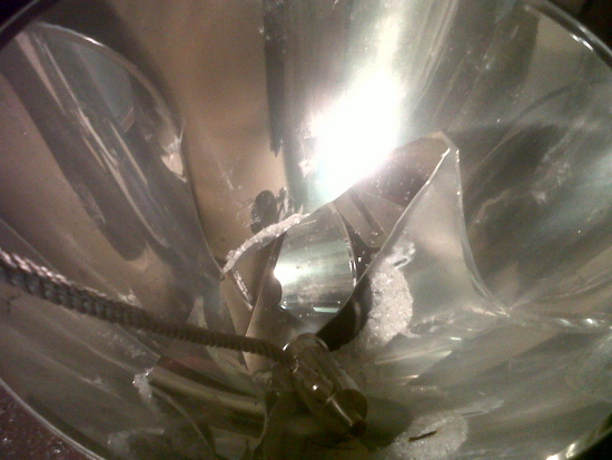

Here is what it looked like. Notice the Cathode.

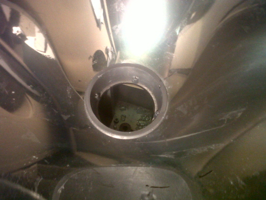

Here's a picture of what's left of the bulb:

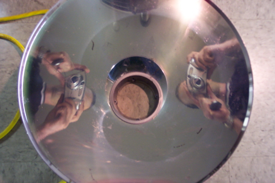

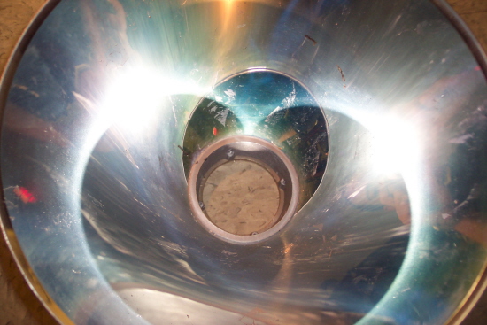

Our dealer is helping with the warranty claim. They are in contact with Strong about a replacement collector and 45 degree mirror. Here are a couple pictures of the collector:
There are nicks and scratches in the surface and a few burned spots. I have heard that many theatres keep trucking with damaged reflectors like this.
The lamphouse blower is working properly.
This bulb was an Osram XL lamp.
I am concerned about Strong not having replacement dichroic 45 degree mirrors. Should this be the case, I was told to check out a glass shop for some high quality mirrors cut to size, as Strong only recommended IR filtering in 4kw and up. I do have exactly the same equipment in my other two houses but with 2kw bulbs. I could steal the 45degree mirrors from one of them.
