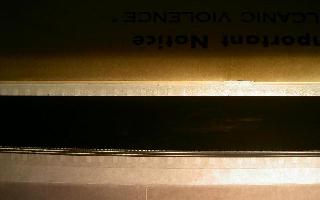

If you can post an image of the first 3 or 4 frames of the film in question, we can determine what your first viable DTS frame is. That will give us an idea of how much film is missing. If the timecode is simply too far into the program, you will have to live with the first part playing in SR.

The suggestion of posting pictures of the first frames with TC is probably not very enlightening because it's play-in music, so there are no frames. Everything is black, apart from the soundtrack. Anyway I'll try to add a picture...!
Had to reduce the size to the absolute minimum, so what was nice nad clear does'nt make much sense anymore now..... Sorry.

Unfortunately that isn't as high a resolution as I need. A close-up of the soundtrack area with the DTS Timecode will help. The image area is not important for this.
