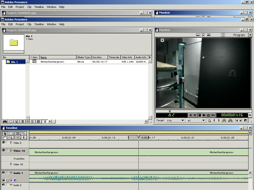

Below is a screenshot of a wavform.  We are going to cut 2 frames worth of audio out right in the center, one on either side of the vertical line.

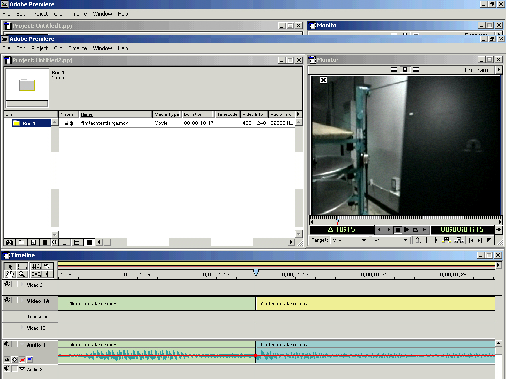

Below is the edited wavform, missing those 2 frames.
It doesn't take a rocket scientist to understand that there will be something lost on an edit like that, for the buildup of the word "shot" is missing from this sentence.  Now granted most reel changes are not mid sentence, but there are enough of them that are, or have gunshots or music where two differing wavforms will cause an abrupt jump in the audio as was simulated above.
